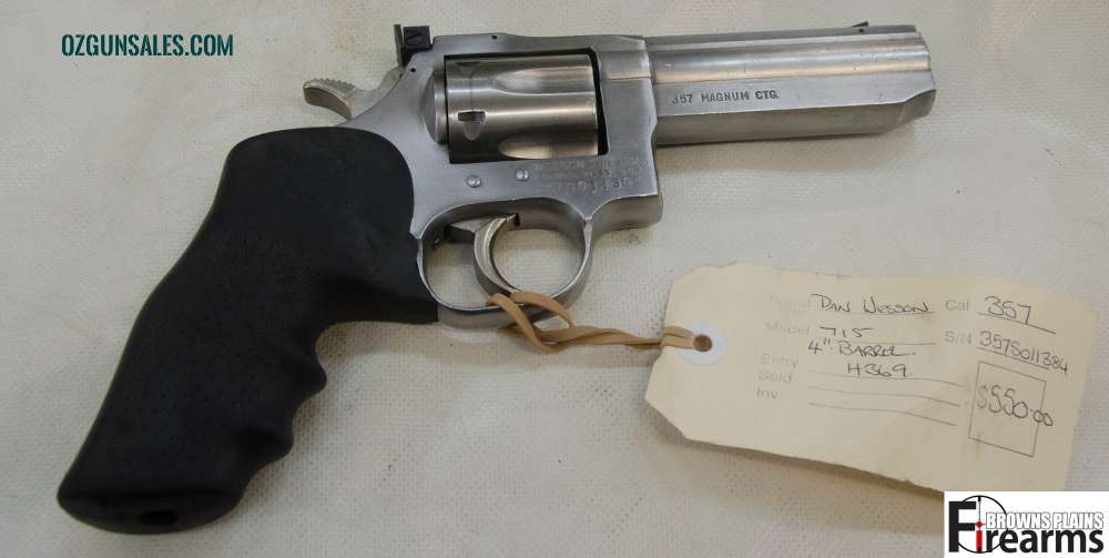

In the display I saw a Palmer Dan Wesson 715 fb with a 4inch barrel. I knew nothing about these revolvers and picked it up for a look and feel. I was immediately impressed by its feel, balance, and nice trigger. This revolver was very beat up with scratches all over the stainless finish a few dings in the metal and a broken front sight. The ticket price was $550 which is not bad in our market here in Australia.
There were brand new Taurus revolvers next to the Dan which I inspected also. Even though they were brand new, they did not have the same feel of quality and the tolerances were not as nice as this Dan. I picked up the Dan again and felt drawn to it. I asked the store owner to put it aside for me while I went about my research. Online I came across this fantastic forum and learnt that Dan’s have quite a cult following.
I could not find very many negative things said about the Dan’s online at all and those who owed one raved about them. Needless to say, I went back a few days later and checked the mechanics on the Dan and all was well. Timing, hammer, trigger, all good. Just a broken front sight and a lot of cosmetic flaws. But I saw it not as it was, but what it could be. A perfect candidate for my first restoration project. With that said, I put a deposit on the Dan.

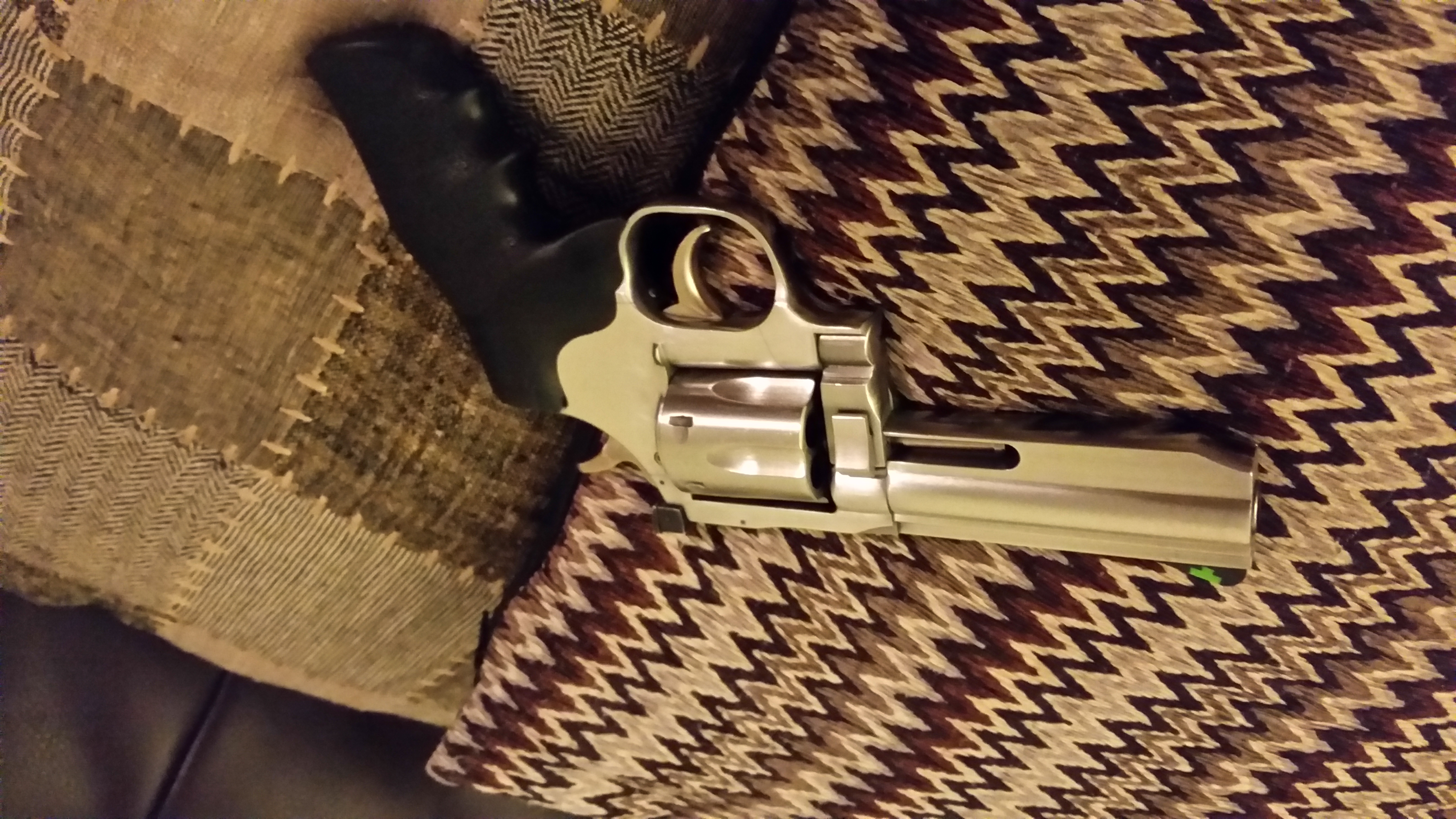

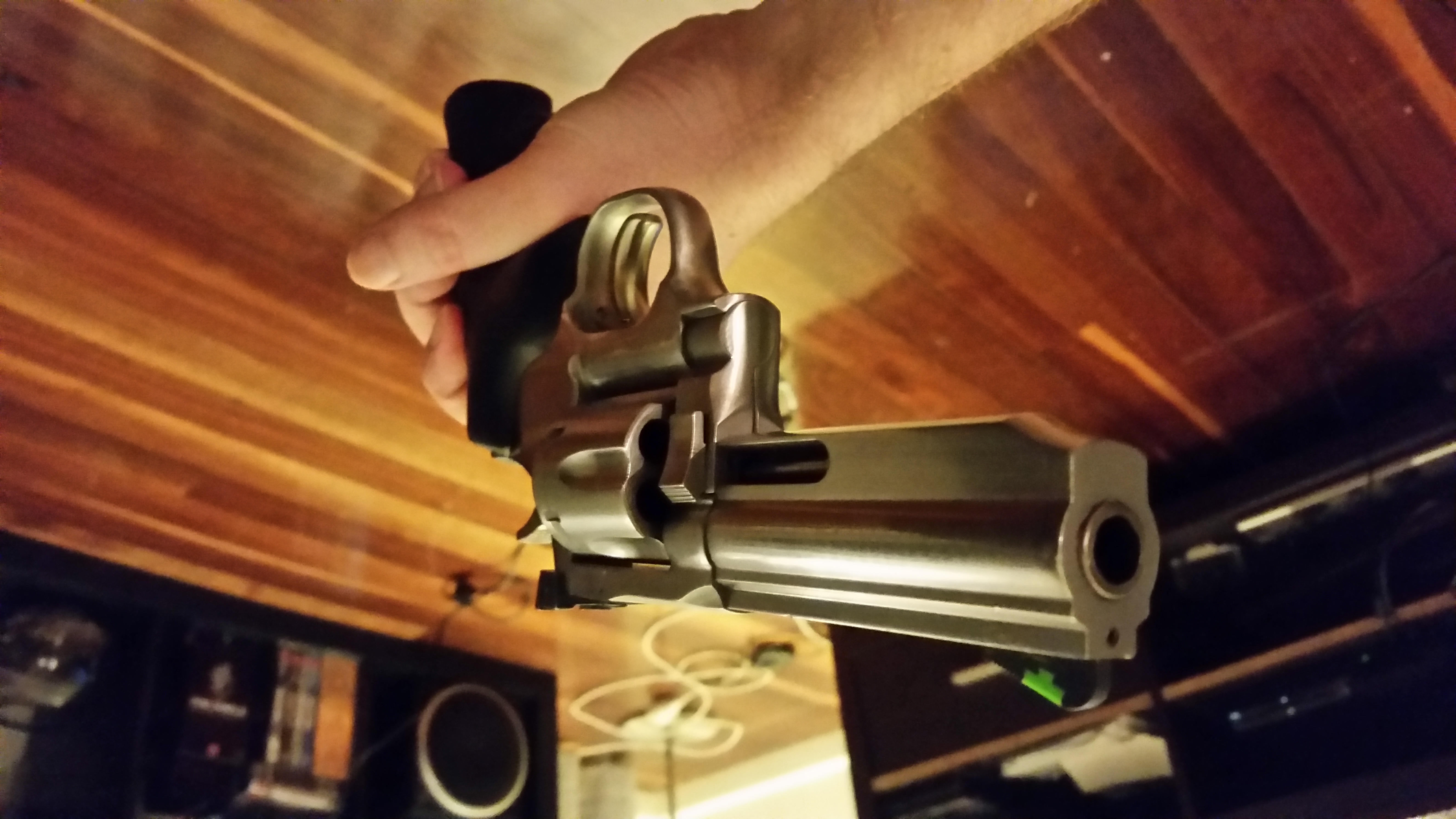

I have not done any serious accuracy testing yet as upon installing the front site when I tightened the front set screw, the front sight leans to the right. Anyone else had this issue? I was puzzled on why this was happening. I spoke to the store who referred me to Ken at KG customs in Brisbane, a local gunsmith. I spoke to Ken on the phone and found out that he had actually performed a tune up and trigger work on my Dan when the store had first acquired it.
Ken did some filling and fitting on the front sight and it is now sitting a little straighter. Ken didn’t even charge me for this. He is an awesome guy. I will take it back to him however, as on closer inspection the front site is still leaning a little and may need some more fitting.
On the stainless finish restoration I used 900 grit wet and dry, a little oil and rubbed away bringing up the clean bushed look again. A scotch bright pad got rid of the burn rings on the front of the cylinder and some frog lube solvent and treatment cleaned her up nicely.
She still needs some finishing touches such as a new rear sight and a bead blast on the top strap, but is starting to look the part now.

How it was when I bought it before the restoration

After restoration (sorry its upside down I don't know how to fix it)

Let me make one suggestion: perhaps the reason the front sight is tilted may be due to the anchor pin at the back having been bent.
It's worth checking out.
You did a beautiful job of restoring the gun.

Welcome to the Forum. Nice work on restoring the Dan. It's amazing what you can learn on the internet and you-tube. I also suggest checking the roll pin that retains the sight. It may have been dropped on the front sight and that's why it was broken. I'm sure you already checked for crud in the slot where the sight rests, but check again.

Thanks for the kind words mate. I thought that a bent front sight pin may be a possibility.  now my challenge will be finding replacement.  thanks for the suggestions with the rear sights.  I have considered  all of those. I was hoping someone might be able to order me an official dan wesson replacement rear sight from Cz and post it to me. I will cover all costs. Great to be part of this great community

Those 'after' shots are tremendous. Great job. I have same model, 6 inch barrel, and it needs surface refurb too. I'll be taking a leaf out of your book.
