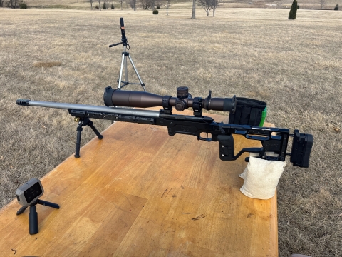

Just picked up my action and barrel from the gunsmith.  He did the chamber reaming for 300 PRC caliber.  When I got home I assembled the Curtis Custom action, TriggerTech Diamond single stage, Bartlein barrel, MDT brake, MDT Elite ACC chassis, Vortex Razor HD Gen III 6-36x56mm EBR-7D MOA FFP scope mounted with Burris XTR Signature 34mm 1.50” rings & Area419/B&T V8 Atlas bipod.
Looking forward to finding the load recipe it likes best.  Hopefully I can get .250” groups at 100 yds.
And then it’s time ring steel at 1-mile!

Seems to be a pretty solid set-up.  Hope she shoots well for you.  I've used the MDT Chassis on Ruger, Savage, and Remington builds- I really like them.

Hope so too!  My 1st MDT chassis.  I have the Woox Furiosa chassis on my 6.5CM and it’s been great.
